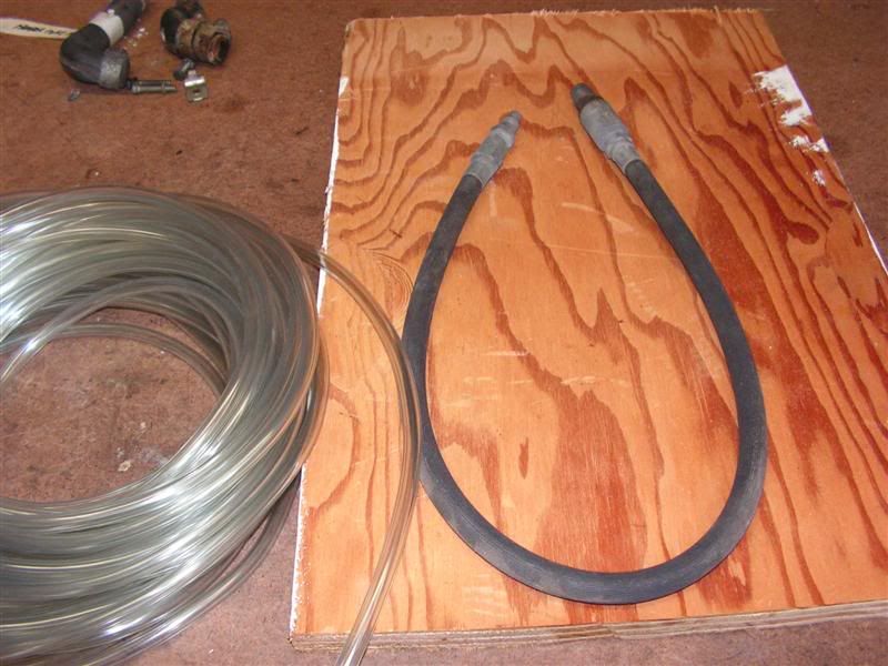

Here's one I made this morning for a friend of mine who just serviced his distributor at my shop, but forgot to mark TDC and subsequently turned over the engine a few times -- now he's lost and his '68 XKE won't start. It's just a few pieces of common shop scrap, an old compression gauge hose, clear tubing, brass fittings, a ruler, and some fasteners

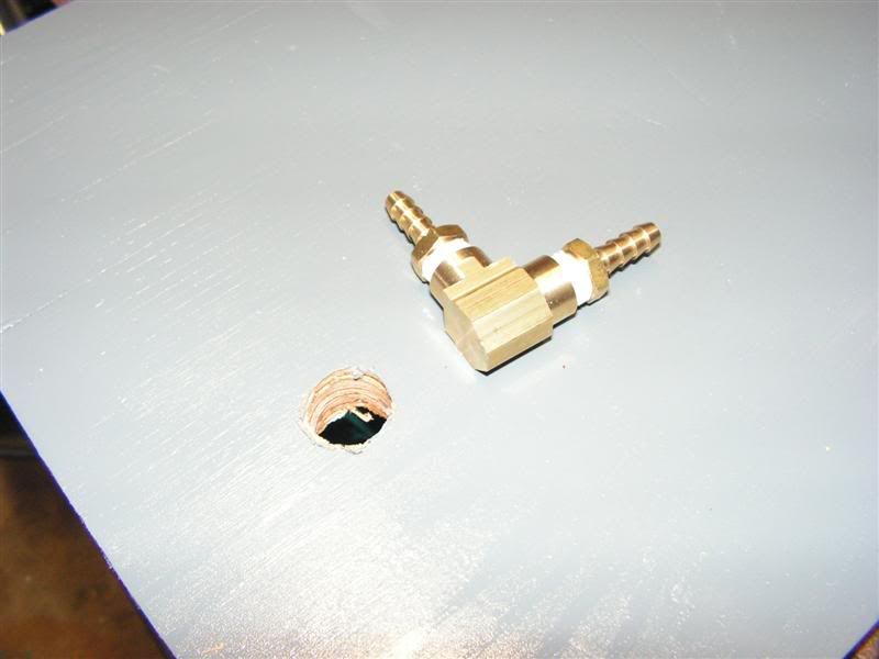

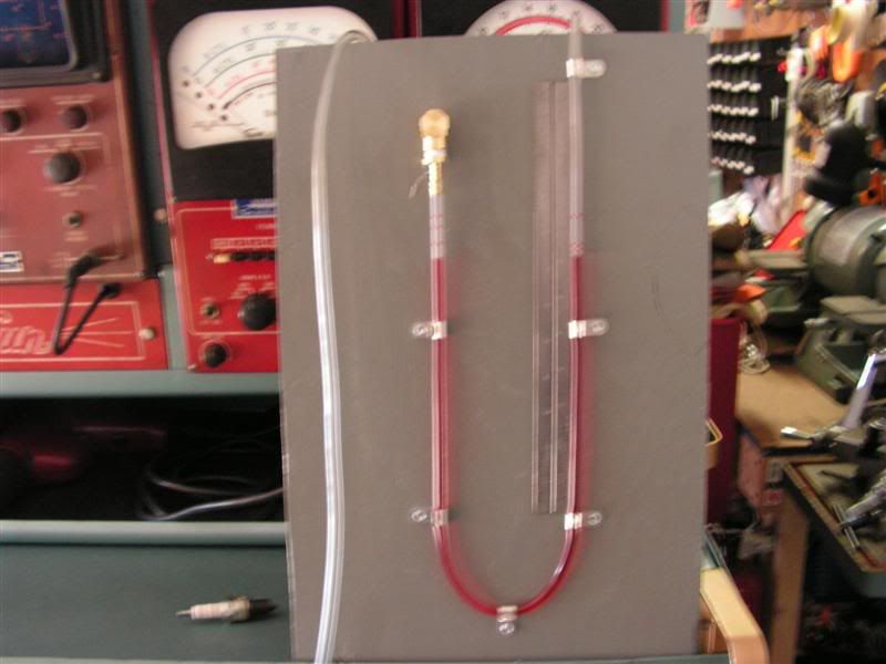

I painted a piece of thick plywoood light grey and drilled a 3/4" hole to fit a 90 dgree elbow with two hose fittings

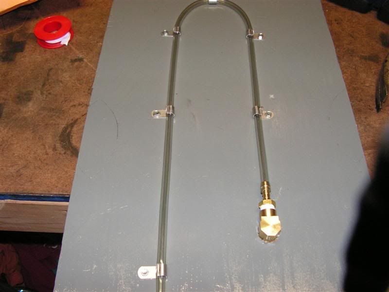

I used hot glue to fix the elbow in the hole and then proceeded to attach 6 feet of clear tubing to the back and also layed out a "U" shaped flow meter on the front of the board with some 1/4" cable fasteners I had lying around.

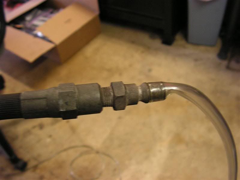

Next I used an old compression gauge hose and attached it to the 6 foot tubing section. This will allow me to screw the hose into a saprk plug socket and then hookup the clear tubing to the nipple on the compression gauge hose.
Note: if you don't have a spare compression gauge hose, just gut an old sparkplug and hook it directly to the clear tubing.

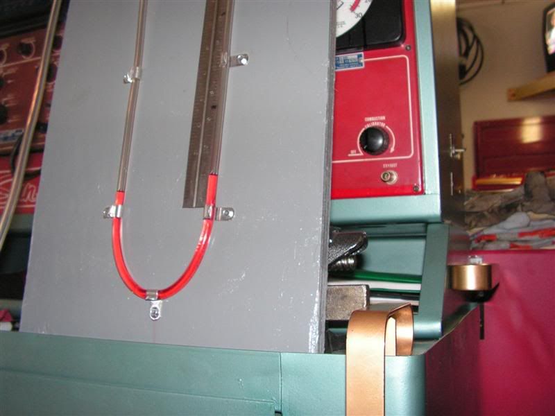

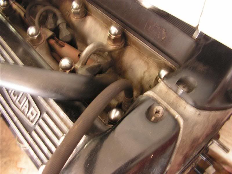

Here's the completed gauge and the compression gauge hose in the no. 6 sparkplug hole on my engine -- just for testing!!

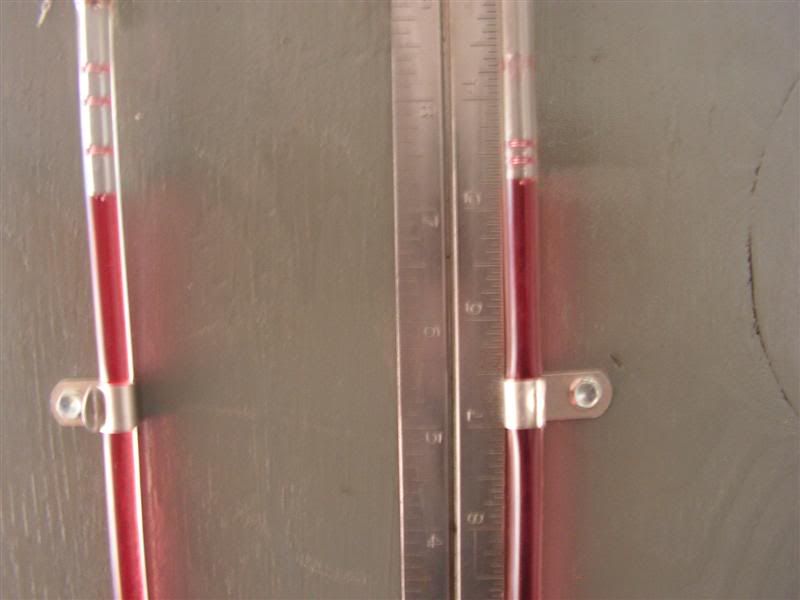

I filled the "U" meter with a red colored oil (Marvel Mystery Oil) so that it's easier to see, and then I mounted a ruler scale next to the tube (any scale will do)

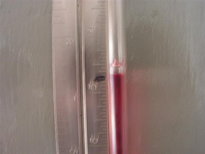

Once the fluid has reached equilibrium then I proceeded to turn the engine slowly over until the the fluid just started to move in the positive direction. I then marked the scale with a pen and slowly continued to to turn the engine over until the fluid reached it's peak hight. That spot is also marked with a pen on the scale and represents TDC.
To fine tune the setting, I slowly rotated the engine back and forth and observed the fluid level rsing and lowering against my mark-- doing this a few times allowed me to "zero in" on the exact TDC -- when the fluid was at it's peak on the scale.
Any scale will do since you're only using it to set a baseline and then trying to read what the highest fluid level reading is (doesn't matter what the scale is as long as the fluid hight can be readily seen and compared).
It's not "rocket science" -- and it worked real well on my engine. My friend took the TDC finder home and managed to set TDC on his engine within 20 minutes.
Note: if you want very exacting readings, you need to make the "U" meter longer than the one shown in my pics. This one is 1.5 feet long and takes a little fiddling, if it were at 3 feet in length, then the readings would be much more precise.
