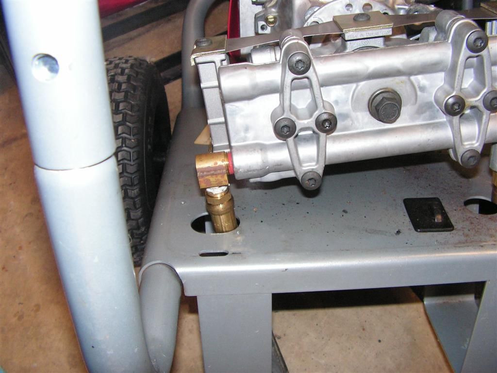

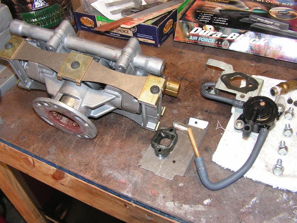

First up is the gas tank and the pressure pump shroud -- funny thing is that to get the shroud off, I needed to remove the water inlet and pressure outlet so that the shroud could slide off the pump.
The lower hose is removed -- which I guess is to prevent the pressure washer equivalent to "water hammer" in a house plumbing system. Then the pump can be simply unbolted from the engine -- it's only four simple bolts

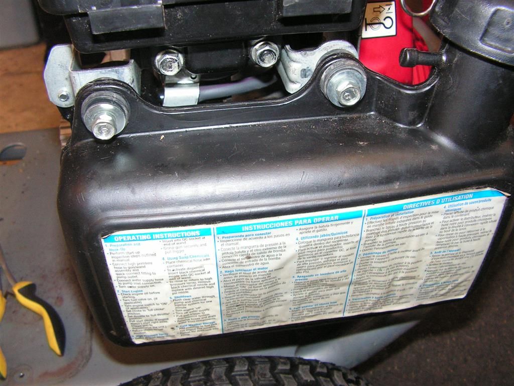

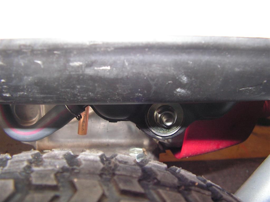

Next comes the fuel tank -- three bolts; two on top and one on the bottom

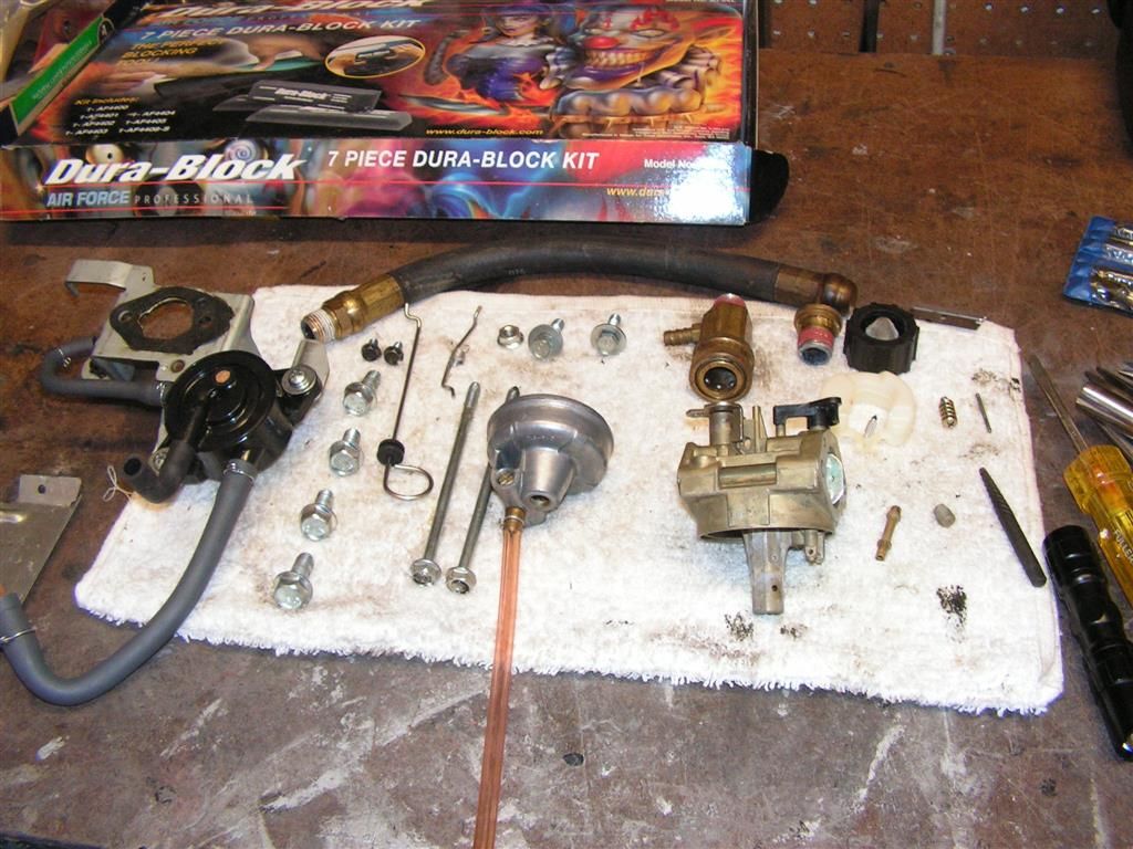

Everything removed and ready for cleaning

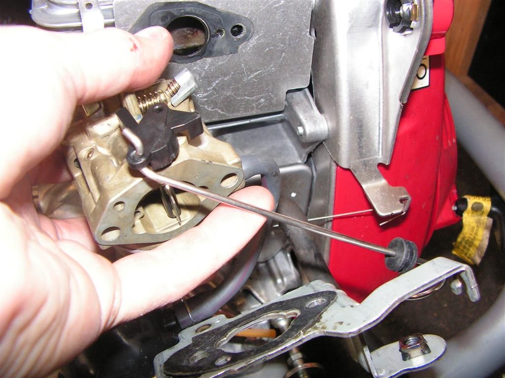

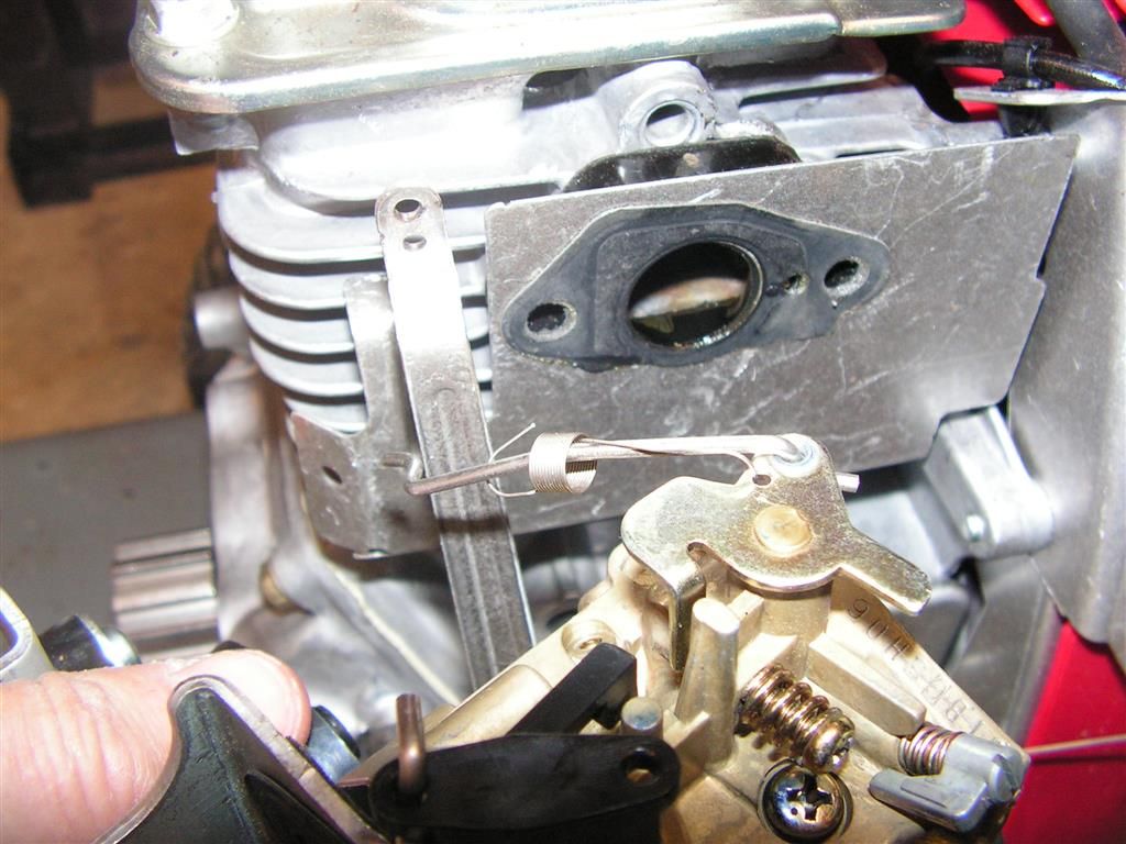

Now comes the carburetor and the idle and choke linkages.

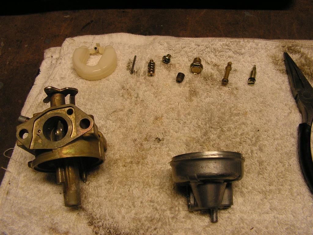

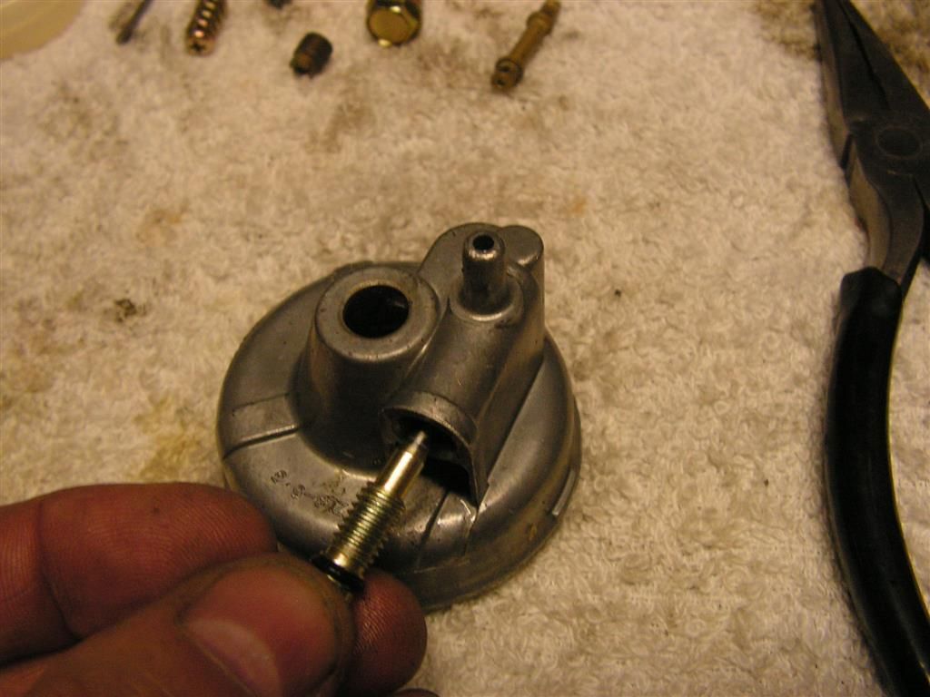

Removed the carburetor and now it's "show-time" to see what's inside. First the bowl is removed by unscrewing the gasketed bolt on the bottom of the float bowl. The bowl was full of water and gas.

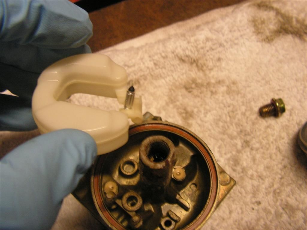

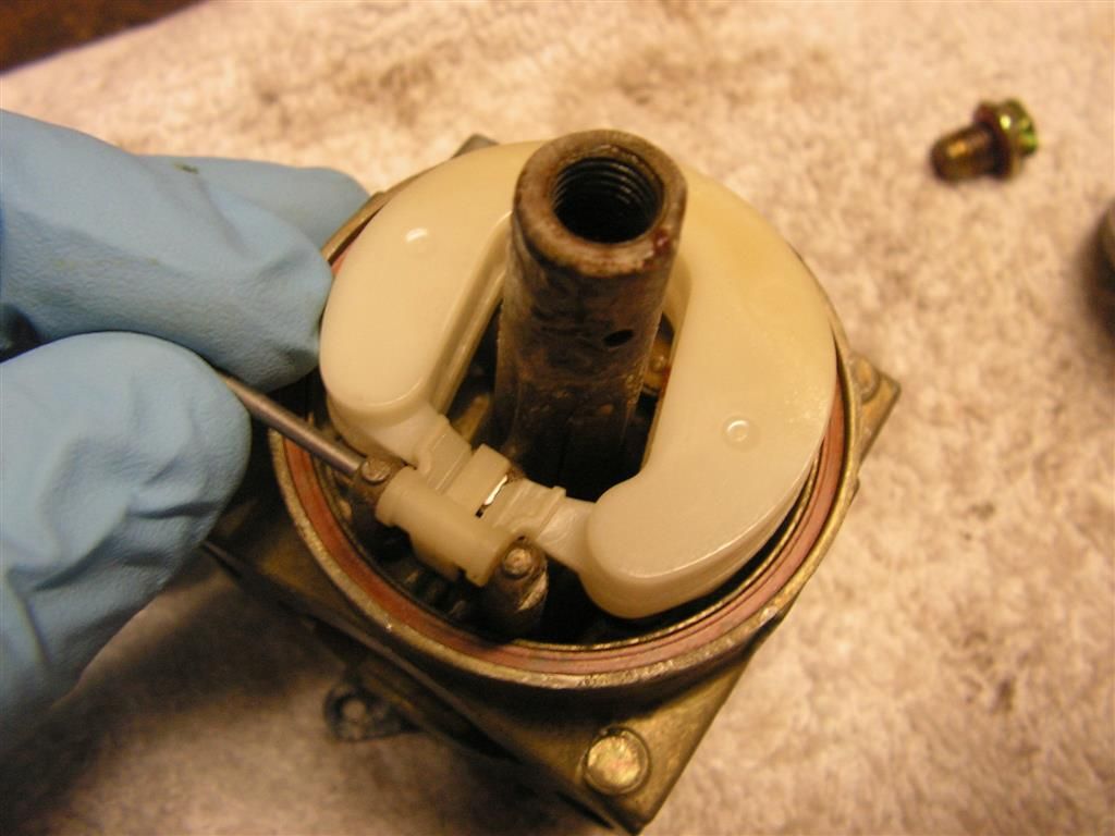

Next, the float and needle valve is removed by simply pulling the link pin

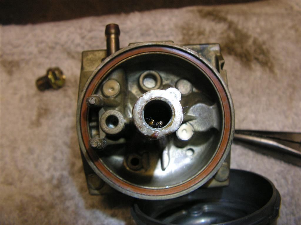

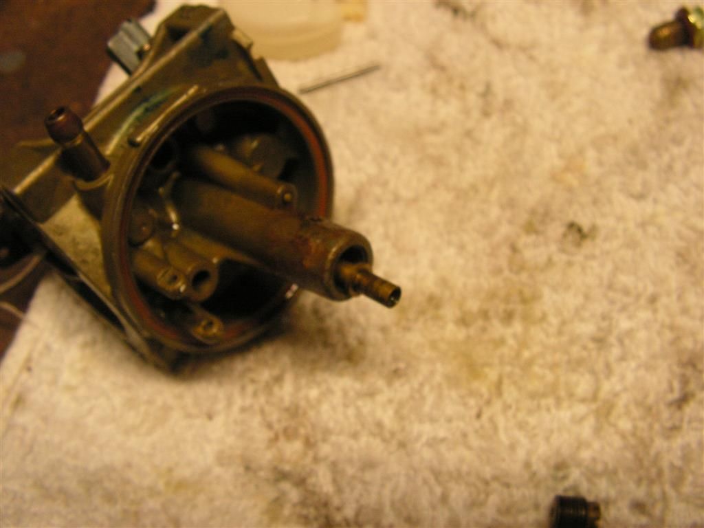

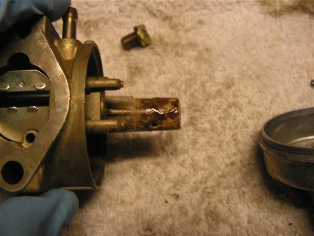

Look at all the sludge on the outside of the inlet tube.

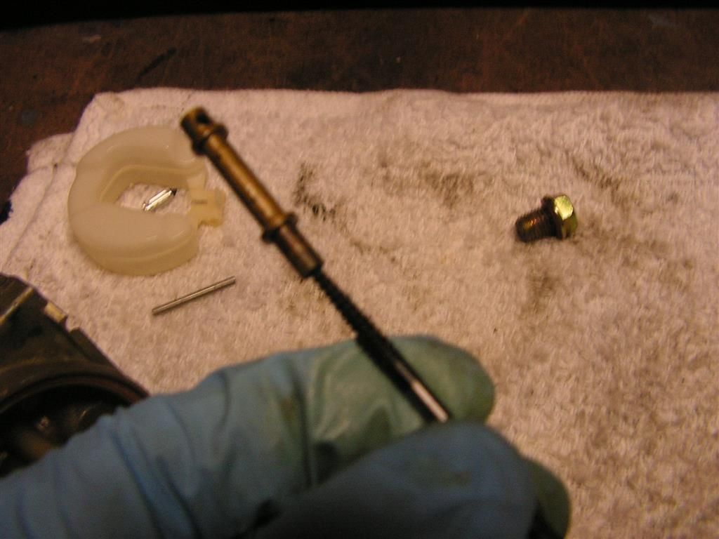

Inside tube is the jet and the venturi tube and it's full of sludge -- clogged tight.
The tube was stuck tight, so I used a small "easy out" to catch it and pull it out. This is about the only time these "easy outs" have ever been useful.

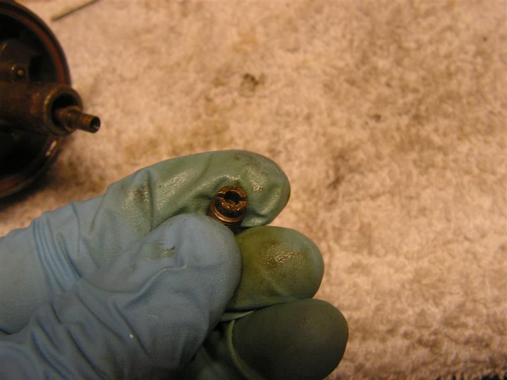

The venturi tube has a series of very small holes drilled into it -- four rows of three holes, and all but one was clogged.
All these pieces (except the float) get soaked in carb cleaner and then they go into the solvent tank for a hew hours.
The fuel drain plug on the float bowl was rusted shut. Had the damn fool drained the tank and carburetor, I would not be in this situation. Here it's being reinstalled after a good cleaning and polishing.

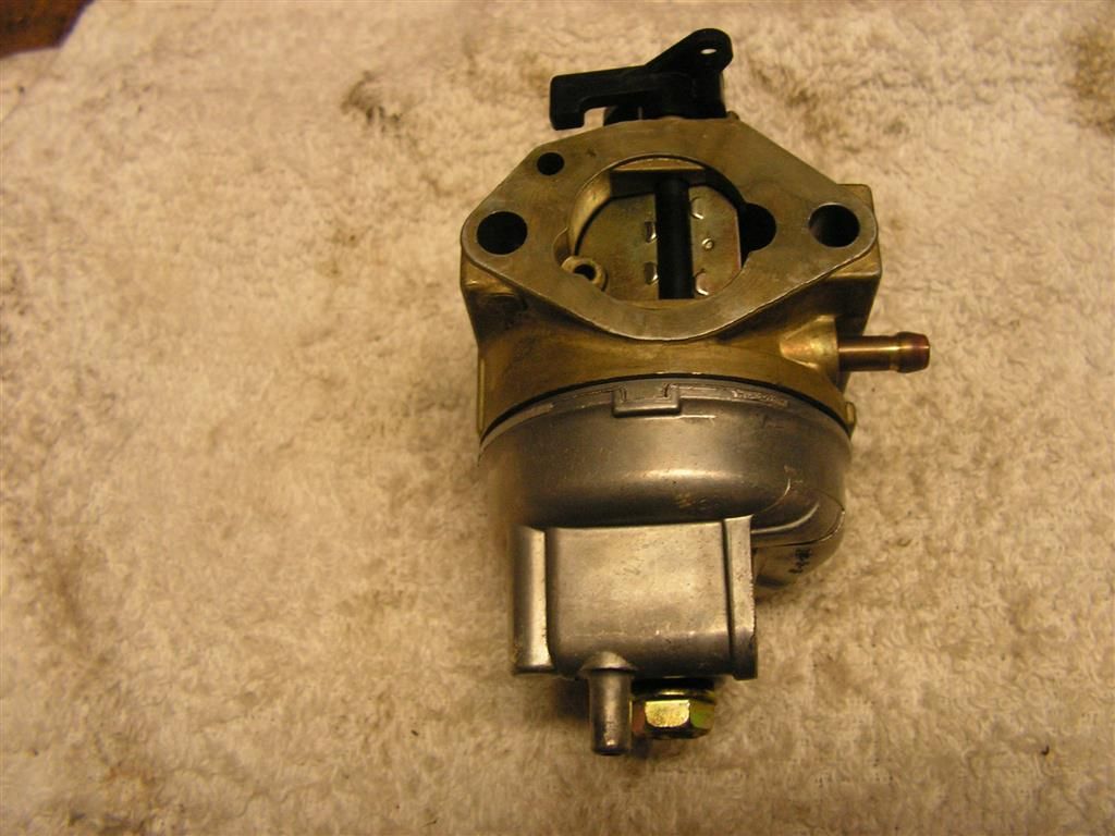

I cleaned the carb thoroughly, but the damage was done. When I put it back on the engine it started sputtering and lurching and had very erratic idle. Luckily I found a cheap new carburetor on ebay for $18 shipped. That carb just needed a small mod to make it work with this engine. The engine fired right up and idled like a watch with this new carb.
The OEM was a GC-160 carb, while the replacement carb was a GCV-160. The new "V" series is definitely a cheaper aftermarket item than the OEM GC series, but at that price it just pays to replace the carb every few years if you're not too thorough on maintenance.

I sprayed the pump with some WD40 and it worked very well. It's idling stead, the unloader unloads, and the pressure washer has good pressure again. I drained all the water from the pump, and all  the gas from the carb via the little side drain (it's not as convenient as the GC 160 carb, but works fine).
