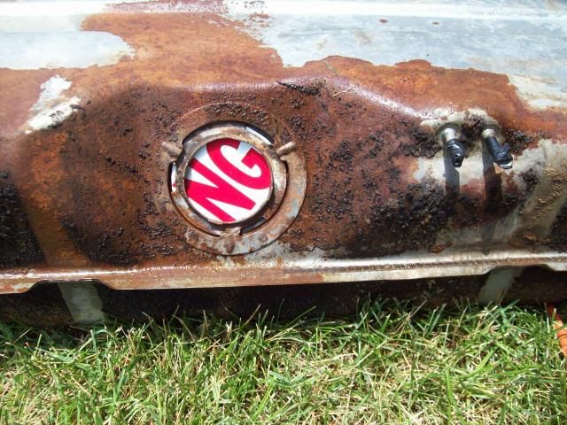

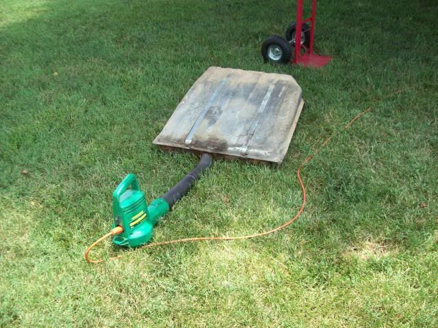

I ordered a kit from KBS to repair my rusty Newport gas tank. (hopefully)    http://www.kbs-coatings.com/
I bought the 25 gallon size for obvious reasons.  They have good instructions and you tube videos to help. But I will do a few pis also.
If you try this a home follow the You tube vids.......
I first made a sending unit plug using the original rubber gasket and tightening ring, and cut a metal no trespassing sign to fit opening, 94 cents at walmart.

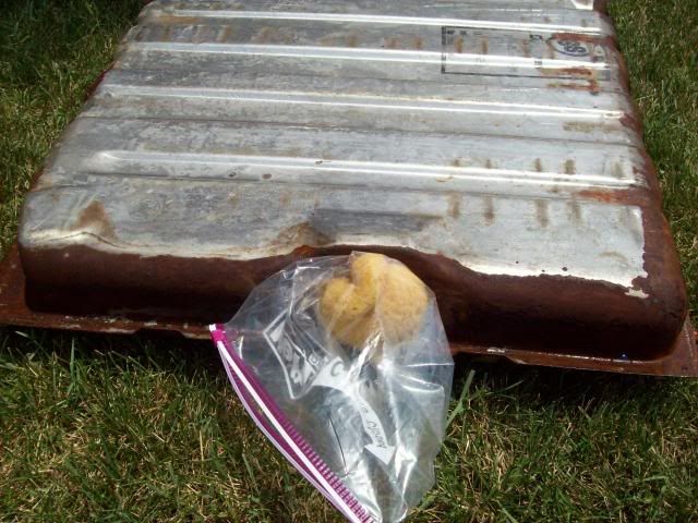

Then taped the vent holes with electrical tape. Then I used a large sponge inside a zip lock to plub other end after I filled with the first step cleaner.   Follow instructions.

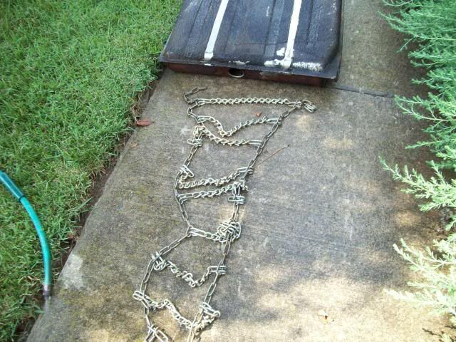

It suggested putting bolts or chain inside for this operation to knock loose rust. I bet you guys up north know what kind of chain that is.

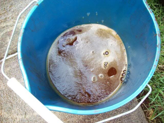

Shake soak shake soak 2 hours, dump soap.
Comes out nasty

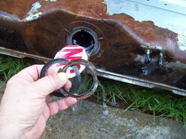

Rinse and blast
Dry out completely this helped.
I will post more on next step

I know welding is better but my torch is 60 miles away. KBS says you can either patch with their epoxy or use small pieces of fiberglass and paint  the sealer on the outside also. It all gets coated on the inside yet. I'm thinking the holes are small enough that I just need them to hold until the coating dries.
Any way i'm done with step two and I am not so impressed. I poured in the quart of deruster, and rolled it around for almost two hours.
I then dumped the remainder in a bucket to save in case I needed to do it more.
Less than a cup left over, not enough to put in again.  Problem is there is still  rust in tank. The instructions say that all rust does not need to be removed. (I hope not, cause there is plenty left).

Yup fixing gas tanks is a pain. It used to be easier though when they were made out of thicker and more malleable steel; so you have a good chance at gettin' it right Fins
Re: Gas tank restore
« Reply #8 on: June 18, 2010, 10:40:48 PM »
You know what happened. The tire chain punched trough trying for traction.  :happie:
  • Posts: 2084
« Reply #9 on: June 18, 2010, 11:04:49 PM »
Wouldn't that be the kicker!!! LOL

Any way I put small dabs of JB weld on my holes last night and did step three as directed this afternoon, I poured in the sealer and rolled it around for 30 minutes. Then poured the contents remaining back out and painted on the outside where I patched.
It may actually work, it seems to have coated every thing. It will have two weeks to cure.
