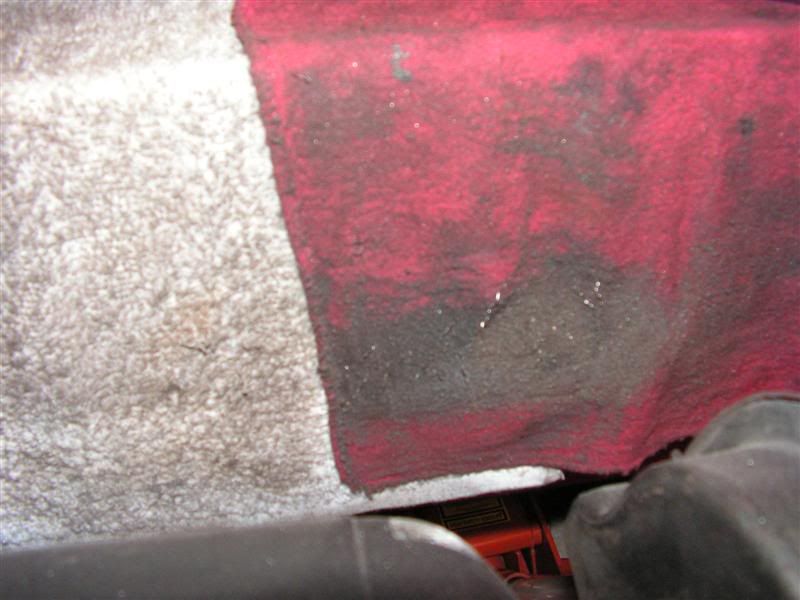

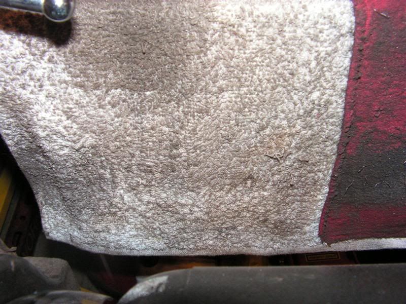

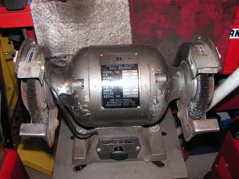

I just realized that this hasn't been disussed. Many of us have a dedicated bench grinder with at least one wire wheel for use in cleaning parts. It's a very efficient way to clean, but it does generate a lot of dust -- dangerous dust. Cleaning fasteners, parts, and tools generates a huge amount of metal dust. That dust often contains chromium, cadmium, aluminum, brass, asbestos (on early bake assembles), lead, and a host of other nasty heavy metals and compounds that are turned into air borne particles by the force of the wire wheel.
The best solution is to use a water trap where the exhaust ports of the bench grinder are hooked into a manifold of PVC pipe and run into a sealed 5 gal bucket (with a little water on the bottom) via a flexible plastic hose (such as a shop vac hose). However, if you have a setup like me, where the grinder is constantly moved around the best way to trap most of that dust is with a heavy cloth blasting buffer that is dropped right behind the exhaust ports of the grinder. The fine particles will hit the heavy cloth and become trapped while the heavy particles will drop on the floor. This is not optimum, but better than nothing.
In these pics i setup such a cloth barrier behind my grinder and you can see the dust that was captured from just a few days of work. Once the cloth becomes saturated with broken wire and dust, it goes into the trash.
