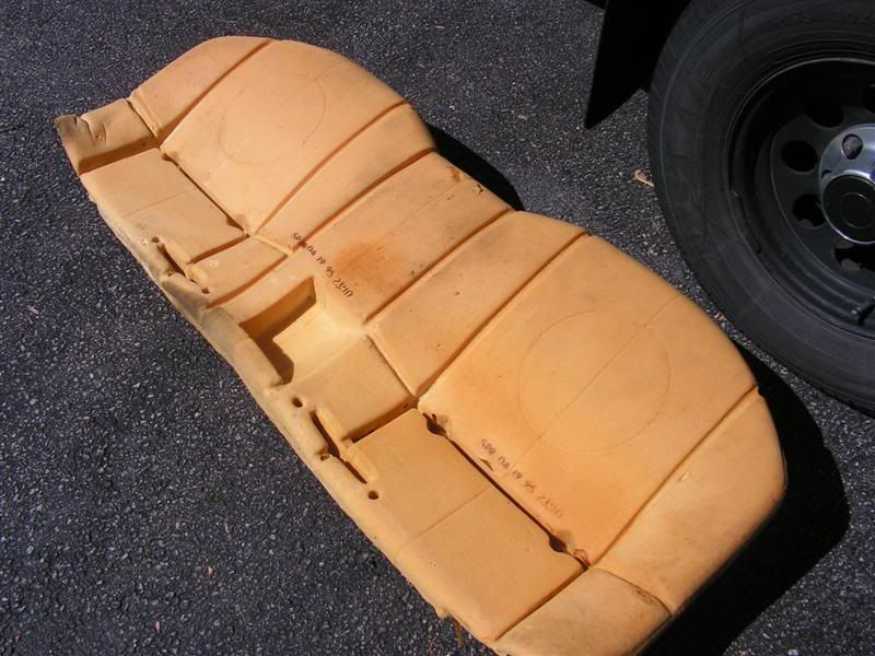

A new seat cushion was impossible to find, and a used bench seat was amost $450 -- so I decided to clean the seat myself. I stripped the seat cushion on the ground and proceeded to soak it with straight laundry detergent along with water form a garden hose. Then I used a sledge hammer as a weight to gently push on the foam cushion to squeeze out the dirty water and then release by adding fresh detergent and water. This agitation took three hours and most all the oil was washed out of the foam in that manner. The seat cover was first washed outside with detergent and water, and then given two cycles in the washing machine. Everything came out pretty good --

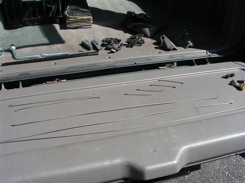

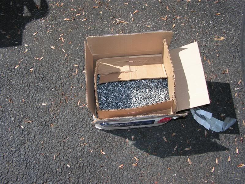

First I put the seat cover in the sun for an hour. This makes the vinyl flexible and I won't need a heat gun to smooth out corners and flats. The basic tools are KD  hog ring pliers and 1/2" hog rings. I got lucky, I got a bulk lot of differnet size rings so I'm good to go --

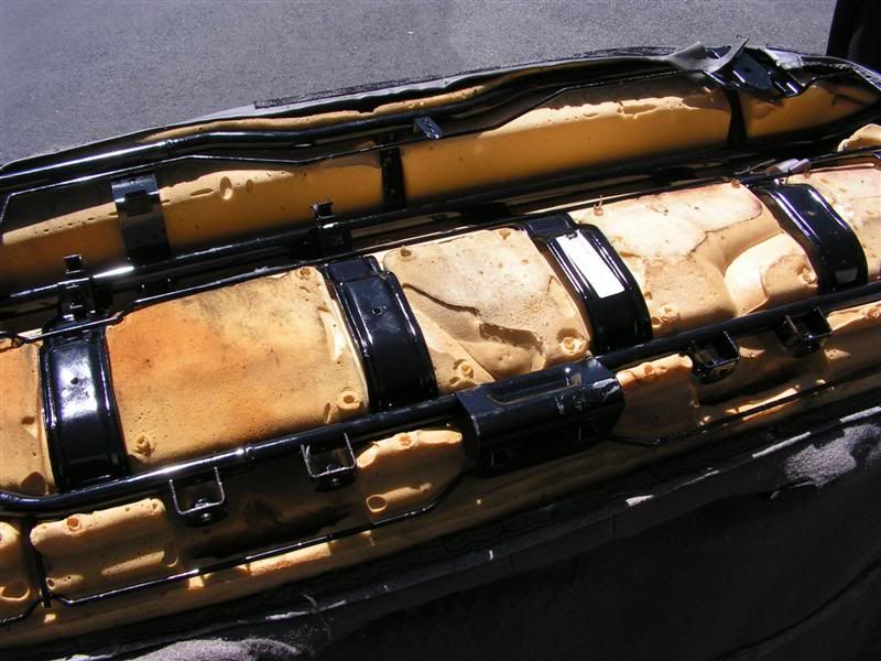

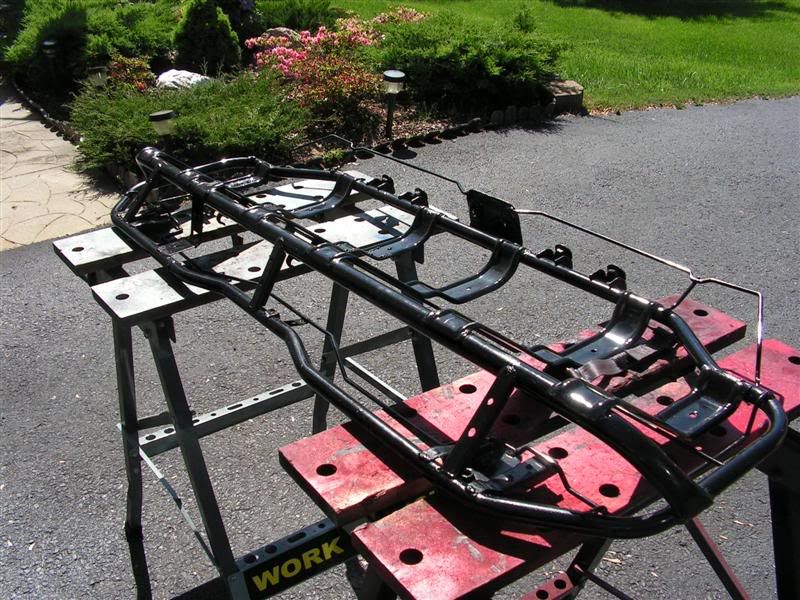

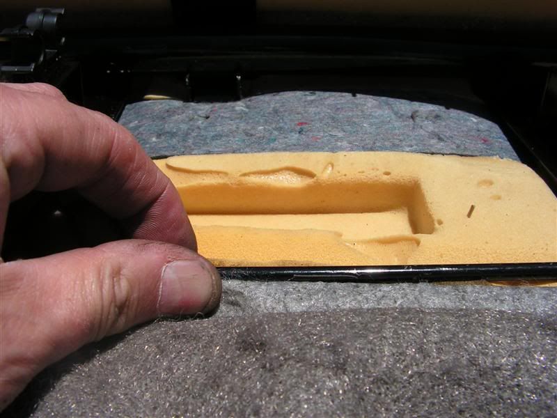

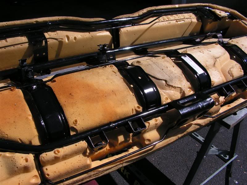

Here's the pressure washed frame, the clean foam cushion -- along with all the hardware

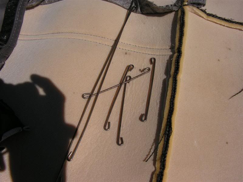

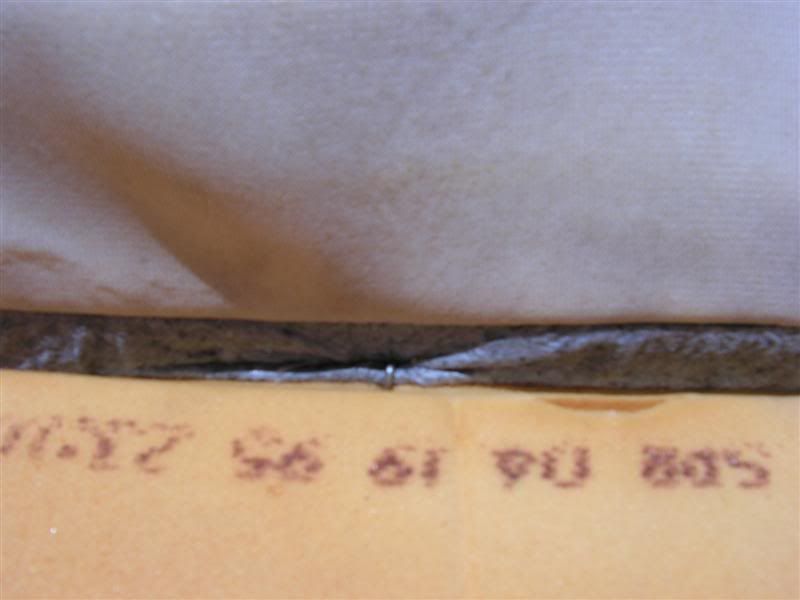

Most important are the "stays" that the hog rings will attach to
Stays are matched to the seat covers and the foam is matched up to the frame to be test fitted

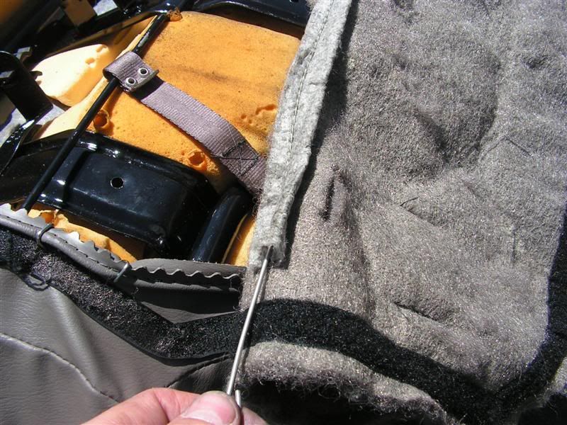

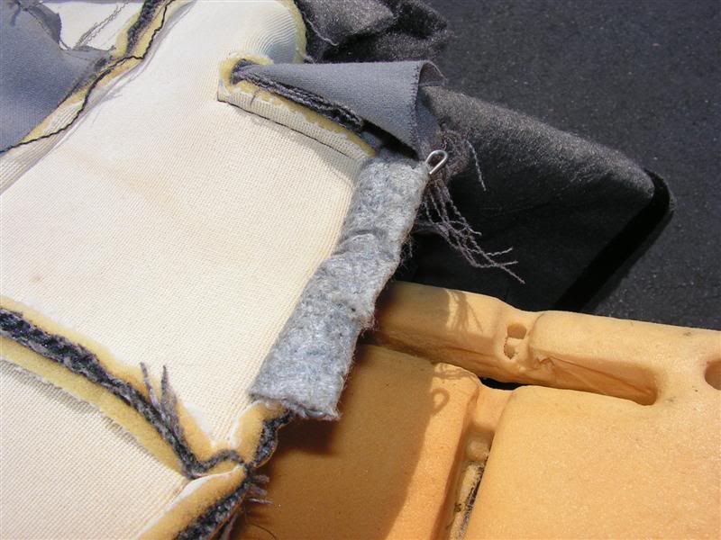

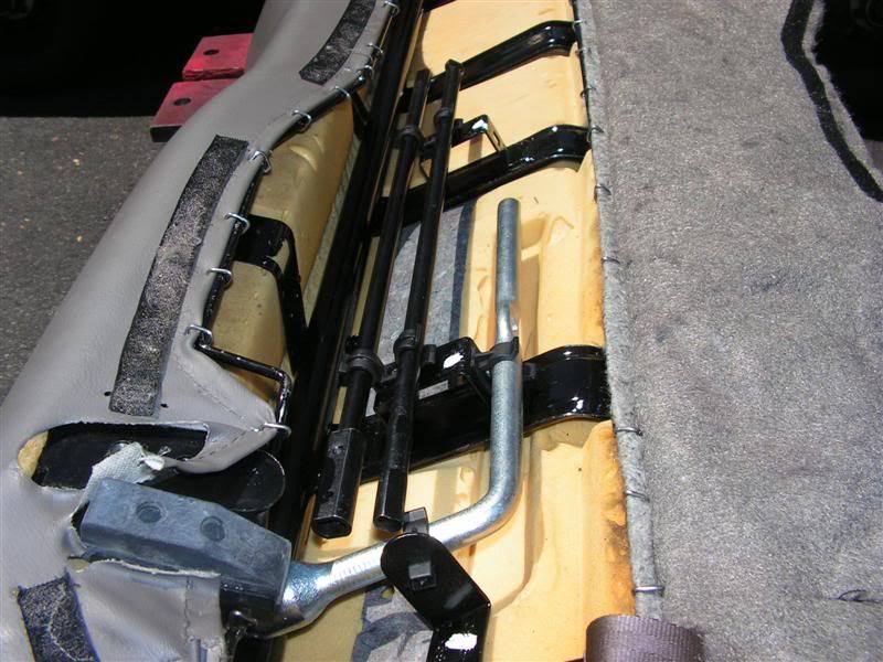

The inner stays are done first. These little stays are attached to rods that are embedded in the top of the seat cushion. By attaching these little stays, the tops of the left and right seat areas will have a pleated outline. There are three per side -- so lots of hog rings needed for this job

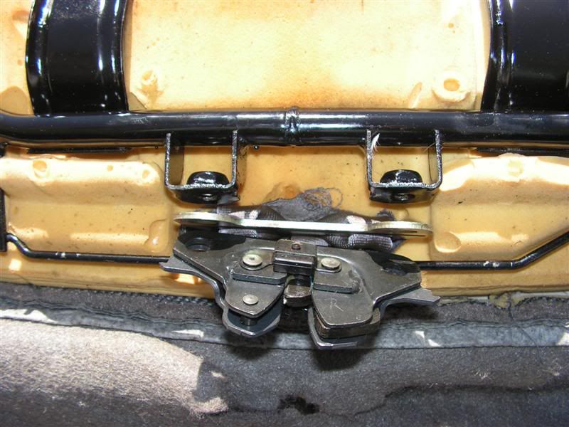

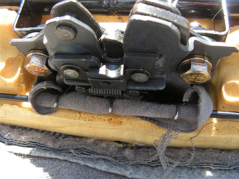

Next the seat cover is pulled over the cushion and onto the frame -- most of the hardware (like these locking brackets) is attached at this point
The seat belt loops are attchached behind the locking brackets and fed through cloth sleeves to the front of the cushion and seat cover.

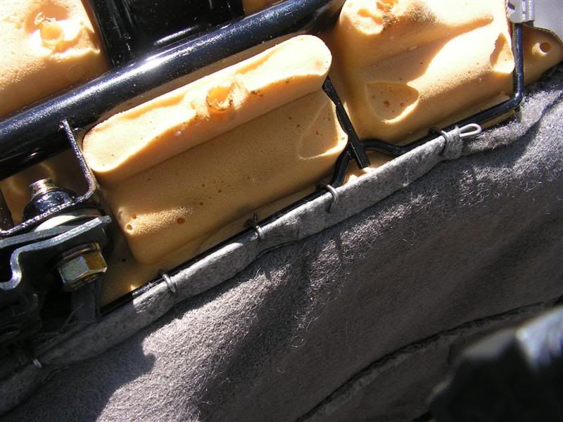

The cloth sleeves are secured with hog rings to the seat frame

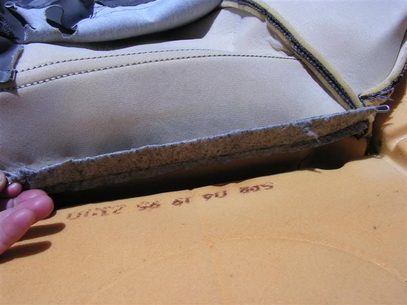

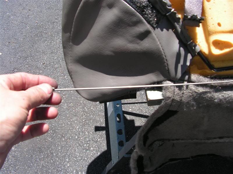

Next the lower stay is secured to the frame -- it's best to work from the inside out in order to keep stretching the material evenly as I go along.
Nice and tight up front -- that tension is all due to the lower stay

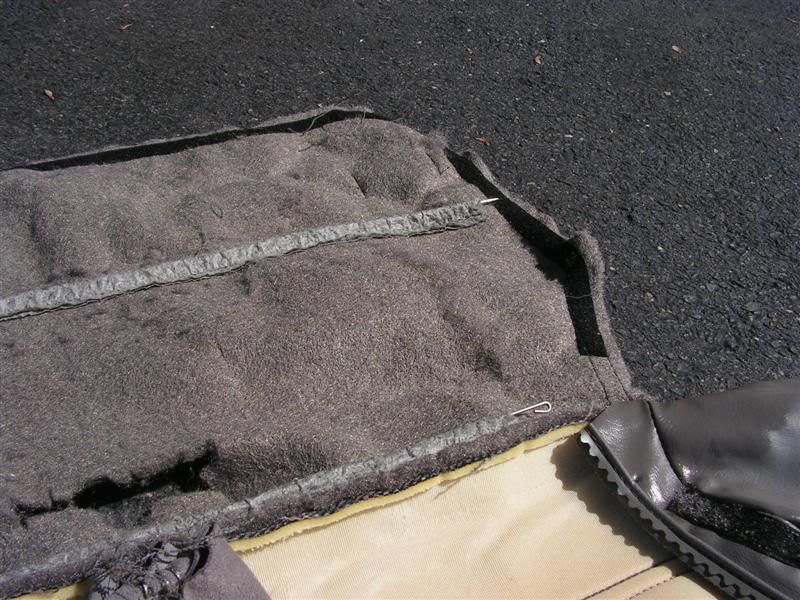

Intermediate stay is inserted in the cover and secured with more hog rings

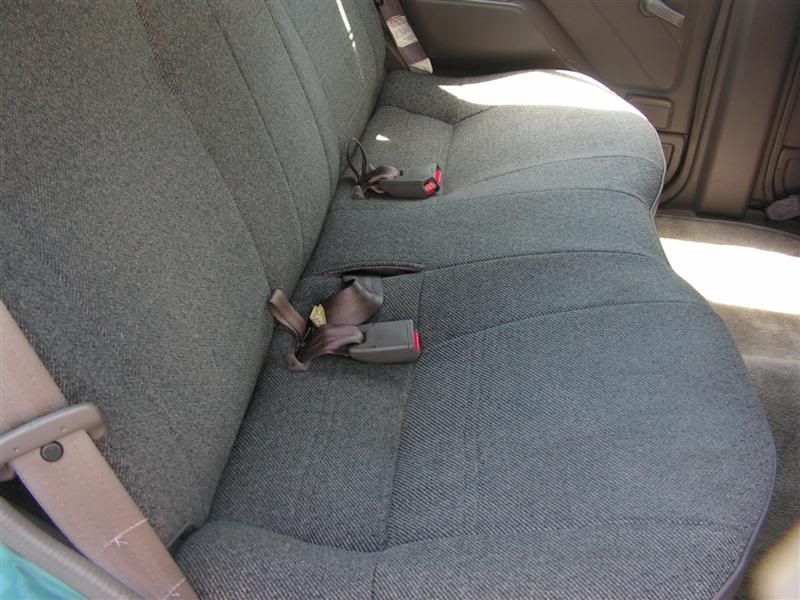

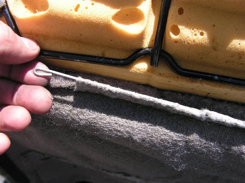

Finally the upper stay is secured and everything is given one more good stretch for overall tightness --
Done -- this took about two hours to complete. All the jacking tools are replaced and the seat is put back in the car.
