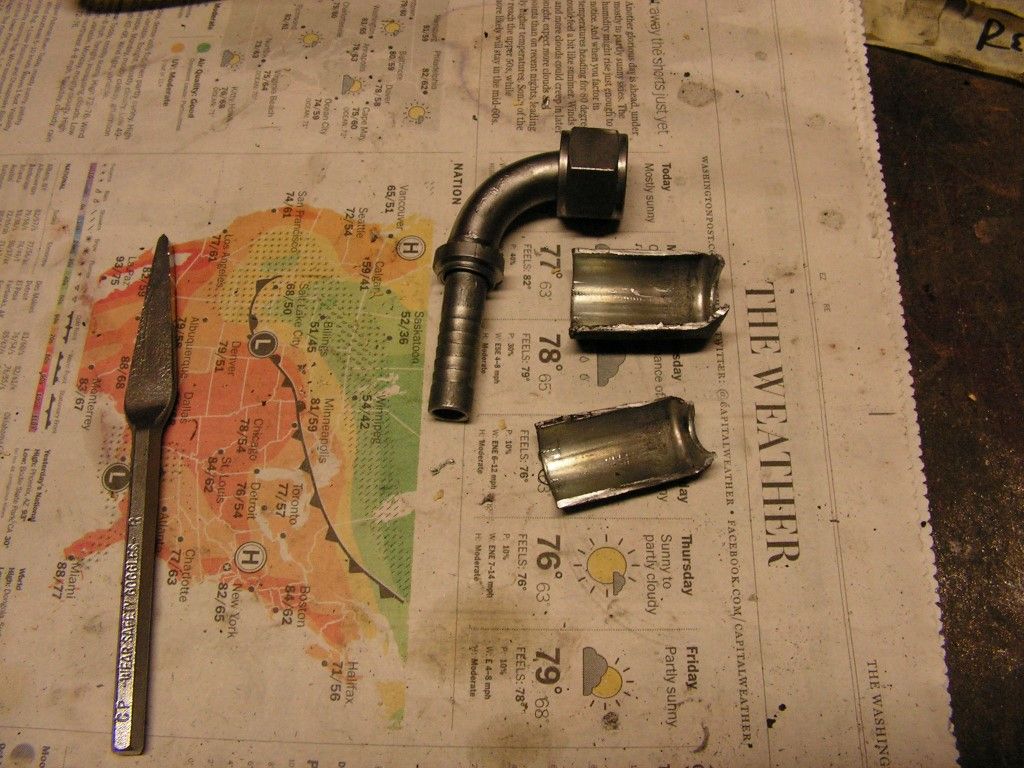

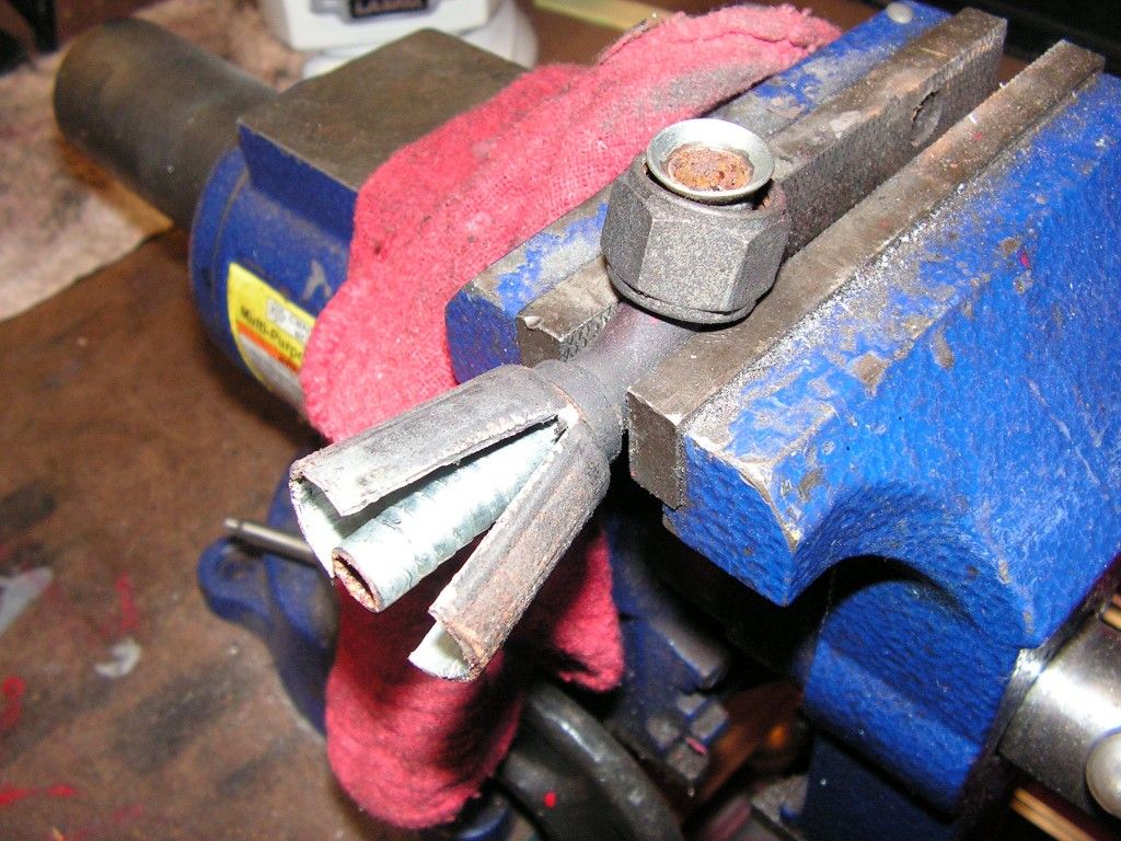

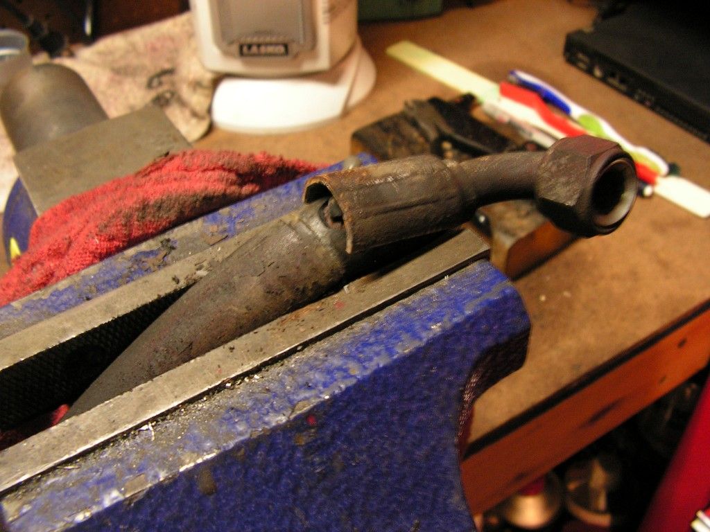

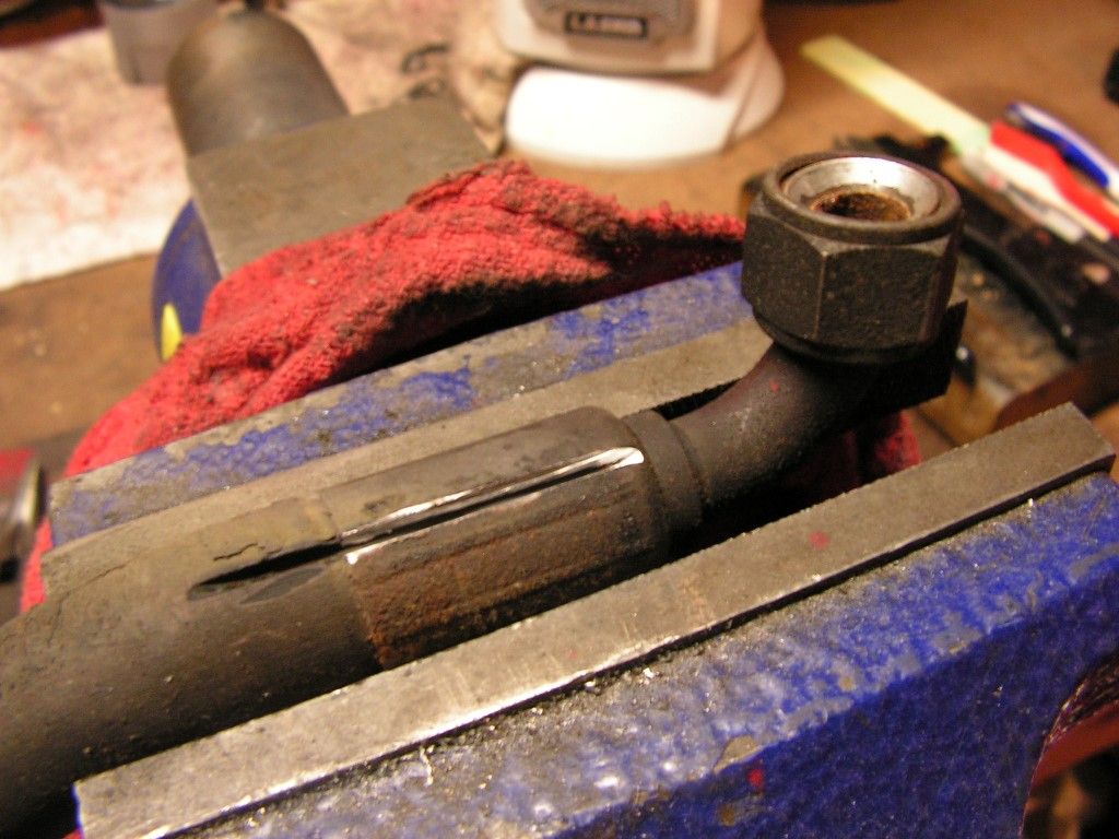

Before I get any further with this AC system, I had to make sure that the OEM hose fittings could be successfully extracted from the old ferrules and hoses. The hoses are pretty crusty and the fittings are rusty inside, but if I can remove them from the hoses, a good soaking in rust remover will clean them up quickly
First I used a small thin cutting wheel to slit the OEM ferrules on opposite sides. Then used a small chisel to separate the ferrule casing from the hose -- this was pretty tight and gummy. Once the ferrule sides were split and separated, the hose barb could be loosened with little effort.
The barbs, ferrules and hose ID were measured with a dial caliper and it turns out that the ferrule is a #8 size, the old hose has a 3/8"ID, and the Mastercool set has an appropriate #8 die.
The other fitting was removed in a similar manner -- success! I can now order some bulk AC hose and ferrules to make up a fresh set of custom AC hoses.
