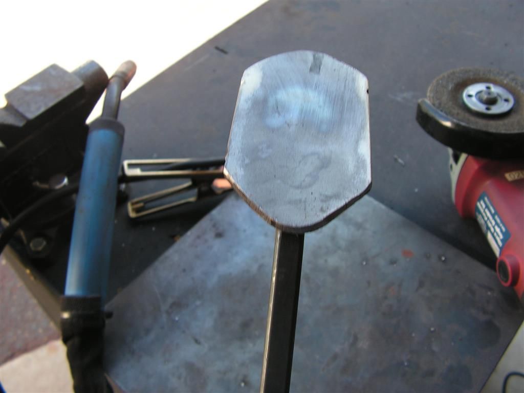

I needed  little bit more reach while doing some sheet metal work. My regular slapper was about 3" too short, so I made this. Cheap HF pry bar out of my road box and a scrap piece of 1/8" plate.
Grind or cut the plate to size with some rounded edges so as not to gouge the sheet metal, and then make it pretty with a flap wheel
Weld the pry bar to the plate -- done!!!
Sand and shape the plate accordingly, and then put a slight bend in the edge to facilitate accurate center hits on the slapper plate
Clean it up a bit and polish the bottom
Total cost? a few bucks, and it works just as well as a $50 name brand -- Good luck!

Used it yesterday -- works pretty well on 20ga steel. Makes nice smooth metal out of cratered panels.
